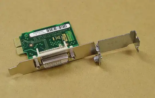

If the Dell has normal-profile slot covers (around 12cm in length), any standard card should fit.
Otherwise, you will need to find a manufacturer that offers low profile cards with either a replacable slot cover or one where it is possible to shorten it like this one:
However the only cards I ever saw that allow this are all server grade controllers and stuff like that, and Matrox graphic cards, which are excellent but have poor 3D performance and a high price.
