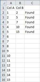

I would use a combination of IF and VLOOKUP. Assuming your data is in Col A and Col B, place the following formula in Col C
=IF(VLOOKUP(B2,A:A,1,FALSE), "Found", "Not Found")
Drag the formula down, and the results for your example would be as follows.

Here's a screenshot of both methods in action. The first formula in this answer was used for column C, the second is in column D.
