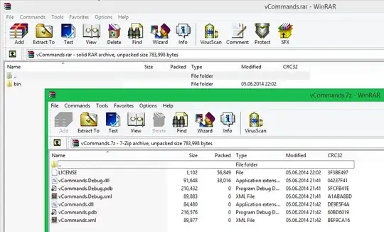

I need to grab every file in a folder and shove it into a RAR archive.
This is my current method:
"C:\Program Files\WinRAR\Rar.exe" a -r -md2m -s -m5 -ma4 -t ..\Releases\vCommands.rar bin\
... Where bin is my folder. I tried this too, even though it is for another program, and the results are the same.
To be clear, here's a picture:
difference
To the top-left, in the .rar file, there is the bin directory which contains all the files.
To the bottom-right, in the .7z file, all those files are in the archive root.
What I need is shoving all those files in the .rar archive root, instead of a folder, without having to execute my batch file inside that bin folder.
