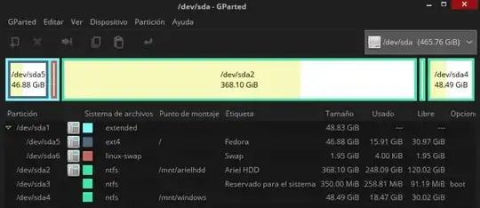

  1. It looks like an HDD failure or a corruption in your partition, formatting is your best bet.
    • The ubuntu DVD won't fix windows boot, it'll install its own boot loader.
  2. You can make a backup safely from a bootable live linux distro (like ubuntu) to an external HDD.
    • If you don't have another HDD you can use gparted from ubuntu to create a small partition at the end of your HDD to save your files. Be careful, you won't be able to wipe the disk completely and maybe you could end with some bad sectors left.
  3. You can also use that live image to check your HDD's status and SMART data with the gnome-disks app to know if it's ultimately faulty/prone to fail.
    • You may need to install these apps, so in case they're not already there you may run apt-get install gparted gnome-disks from any terminal emulator.
  4. Once you've made a backup of your data you can create a new partition table and wipe your HDD completely with gparted.
This is Gparted Gparted
