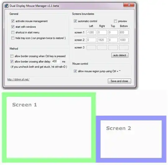

I found a good tool that I believe will accommodate this. While I'm not sure it's possible for Windows to recognize the top screen as independent from the bottom three screens, there are tools that allow you to lock the mouse within a screen.
This thread on Gaming lists several mouse locking tools, but unfortunately, most of them assume you want to lock the mouse within a single screen (and maybe this would work with with Eyefinity).
But I found DDMM which allows a pretty open configuration of "screens", which can be any area. So I can define one "screen" for the top monitor, and another for the bottom three monitors.
As you can see in the options, you can allow a "soft" lock which will just delay the mouse crossing borders, or you can have a "hard" lock which will require holding the CTRL key down to cross borders.
I don't have this monitor setup yet, so I can't confirm for sure that it will work. But based on some tests I did across two monitors, it seems to work like I want it.
Like I said, the caveat is that Windows still will not recognize these borders, so you can't, for example, drag a window to the top of the screen for it to maximize. But there are workarounds for that I should probably be using anyway.
DDMM Screenshot
