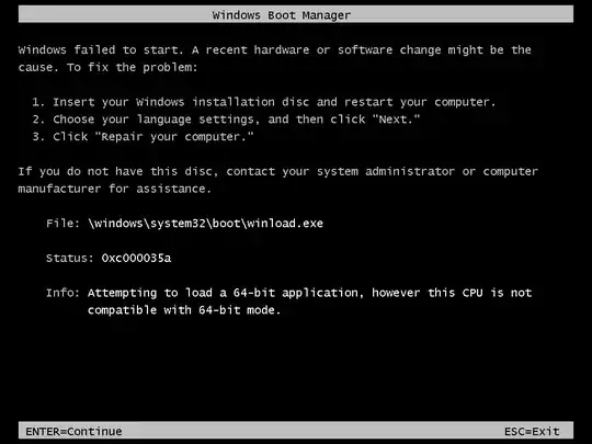

I have successfully installed Windows Vista 32-bit in a VM with VirtualBox. Now I'm trying to do the same with Windows Vista 64-bit and it just isn't working. I have created the VM but it seems that it won't boot off of the 64-bit Vista ISO image. It spits out this boot manager error.

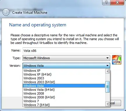

The host OS is Windows 7 64-bit on a 64-bit Intel Core 2 Duo processor. Now, I have done the same thing and installed the same VirtualBox version on another computer, also running Windows 7 64-bit, created the VM, and then... during the VM setup process I noticed that it had additional options to choose from when I pick the guest Os. Here's a screenshot.
b
You can see those options in-between where it says 64-bit, I don't have those options on that other computer. Now, this one runs an Intel Core 2 Quad, a higher end model. It supports Intel virtualization technology, while the other one does not.
This is what the same dialog looks like on the Core 2 Duo computer. Here's a screenshot.
c
Could this be the reason why? Does that mean that you can't emulate a 64-bit Windows guest OS at all with VirtualBox, unless your processor supports Intel virtualization technology? I understand that this technology makes things much faster, but not letting you emulate that OS at all... that's a bit extreme, no?

Section 3.1.2 of the VirtualBox manual explicitly states that you need hardware virtualization support to use 64-bit guest operating systems (emphasis added):
VirtualBox supports 64-bit guest operating systems, even on 32-bit host operating systems, provided that the following conditions are met:
  1. You need a 64-bit processor with hardware virtualization support (see Section 10.3, “Hardware vs. software virtualization”).
  2. You must enable hardware virtualization for the particular VM for which you want 64-bit support; software virtualization is not supported for 64-bit VMs.
  3. If you want to use 64-bit guest support on a 32-bit host operating system, you must also select a 64-bit operating system for the particular VM. Since supporting 64 bits on 32-bit hosts incurs additional overhead, VirtualBox only enables this support upon explicit request.
Source: https://www.virtualbox.org/manual/ch03.html#intro-64bitguests
Section 10.3 also states this (emphasis added):
VirtualBox's 64-bit guest support (added with version 2.0) and multiprocessing (SMP, added with version 3.0) both require hardware virtualization to be enabled. (This is not much of a limitation since the vast majority of today's 64-bit and multicore CPUs ship with hardware virtualization anyway; the exceptions to this rule are e.g. older Intel Celeron and AMD Opteron CPUs.)
Source: https://www.virtualbox.org/manual/ch10.html#hwvirt
Thus, you need a processor that supports VT-x or AMD-V to use 64-bit guests with VirtualBox. However, QEMU, Bochs and VMWare Player all support 64-bit guests without hardware virtualization support (at least according to this page).
