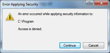

Next I assumed it might be a permission issue and tried to take ownership of the folder. Unfortunately this does not work as well. I get
 Error applying security
 An error occurred while applying security information to:
 C:\Program
 Access is denied.
Error applying security screenshot

The current owner is the administrators group and I am a member of that group. Checking the effective permissions, I have full control (all checkmarks checked). I can create files and delete files inside the folder.
There are no files inside the folder, neither in Explorer nor DOS (dir /a) nor Search Everything.
Some websites say I have malware, but I doubt that. I'm not visiting dangerous websites and I have an up to date virus scanner.
How do I delete the C:\Program folder?

It could possibly be McAfee access protection keeping you from deleting the folder C:\Program\
  1. Disable Access Protection.
    • Click Start, Programs, McAfee, VirusScan Enterprise, VirusScan Console.
    • Right-click Access Protection and select Disable.
    • Leave the Console open.
  2. Delete the folder C:\Program\
  3. Enable Access Protection.
    • Right-click Access Protection and select Enable.
    • Close the VirusScan console.

Have you tried booting into Safe Mode to see if it makes a difference? This should help rule out third-party programs and shell extensions that could could be interfering.
To use Safe Mode, restart your computer and hold F8 just before Windows starts to load.

If you have access to registry, you can try to add this file for automatic removal upon reboot. To do this:
  1. Start -> Run
  2. Type in regedit, and press ENTER
  3. Goto HKEY_LOCAL_MACHINE\SYSTEM\CurrentControlSet\Control\Session Manager
  4. Create a new Multi-String value: PendingFileRenameOperations
  5. Enter \??\C:\Programs as the data
  6. Press OK
  7. Right-click on the key, click Modify Binary Data
  8. At the end of the hex string, add 0000 (4 zeros which represent an empty string)
  9. Press OK
  10. Restart your computer
Windows will try to remove the file upon restarting.
Source: http://blog.notfaqs.com/2007/10/registry-rename-file-on-reboot.html

  • In step 5 I can't enter the value like that. It only accepts the value \??\\C:\Program. Note the double backslash. The double backslash can be anywhere. In step 8 the value already has 4 zeros at the end, in fact 4 bytes of zeros which show up as 8 zeros 00 00 00 00. That said, there seems to be a high risk on that method. Better double check with SysInternals PendMoves, but I don't know what the correct output should look like. – Thomas Weller Apr 30 '14 at 08:31
Maybe Unlocker could help you.

The easiest way would be to use some Linux on a USB drive (with ntfs-3g support), e.g. System Rescue CD. This way you don't have to hassle with Windows NTFS Security or any Trojan which might conceal the file from you.
  1. Boot to Linux
  2. Mount your Windows partition with ntfs-3g
  3. Get into the GUI (for SysRescCD: Enter startx after bootup)
  4. Open the File Explorer
  5. Go to /mnt/windows
  6. Find that Program file or folder and delete it
  7. Exit the GUI
  8. Type halt to shutdown Linux and your computer
  9. Remove the USB drive and boot into your Windows
