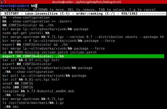

As navigation through history using Ctrl-r is IMO cumbersome, you may want to consider hh:
https://github.com/dvorka/hstr
which makes navigation much simpler, straightforward and efficient - including running the command:
At the bash command prompt, type control-R, then type a few characters of the command you want and bash's readline facility will search through the command history for that command.
After you have started the search, you can type control-R again to jump to the next matching command.
John1024
  • 16,883
