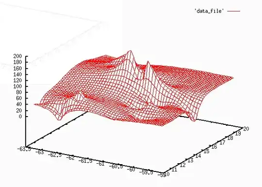

Basically, you plot surfaces with the splot command. data_file contains your example data points.
gnuplot> splot 'data_file'
As you want a smooth surface, you have to specify that you want gnuplot to interpolate the data. Here is an example, see http://www.gnuplot.info/demo/dgrid3d.html for some others.
gnuplot> set hidden3d
gnuplot> set dgrid3d 50,50 qnorm 2
gnuplot> splot 'data_file' with lines
There are a lot of parameters you can adjust, e.g. what interpolation function is used. As it is very hard to cover all here in a general answer, I want to recommend to start with the documentation about splot and set dgrid3d.

  • Is there a way to do this with pm3d? Instead of having a line contour, is it possible to produce a smooth surface contour with interpolation? – V-Red Jun 23 '19 at 14:00
  • @V-Red: Yes, that's possible straight forward... have you tried it? Regarding interpolation please read the link provided in the answer. – mpy Jun 24 '19 at 15:18
    Yes, it works very nicely when I replace with <set pm3d interpolate 1,1> and <splot ' ' with lines> with <splot ' ' with pm3d> – V-Red Jun 24 '19 at 20:43
