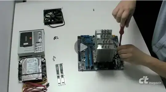

Edit2: Obviously I can not link to an article you have to pay for, but this image seem to be free. It shows a clasical HDD and a SSD. The SSD would draw between 2 and 5 watt, depending per model. A Rotating drive often idles around 10 Watt. I assume that they used a drive which spun down on idle, so you would need to wait for that to reach the 10 Watt of send it a direct command. (E.g. using hdparm -S).
