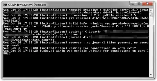

The application I want to start is MongoDB. If I would start it normally, it looks like this:
I don't like the amount of line breaks and I have a lot of screen space, so I would like to utilize said space to get rid of the line breaks.
