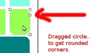

  1. Select the rectangle or square
  2. Select the nodes option
  3. On the right hand corner, you will see a round node instead of a square node. Drag down the node until you get the rounded corner you want.
The nodes option:
2. The Nodes Option
Round widget you need to drag to get rounded corners:
What happens when you drag the round widget:
As others have noted this only works on rectangles (but that is a common use case that will land people on this page).

    What is this 'nodes option'? Screenshots would be lovely. – randers Sep 16 '15 at 19:23
    That's great for rectangles or squares, but how does this help for more complex shapes like the one in the question? – Tom Pohl Nov 28 '15 at 18:04
    It should be noted that this will e.g. not export to a DXF correctly. You can use the menu "Path" > "Object to Path (Shift-Ctrl-C)" to create a real rounded path. – Rocco Jan 22 '18 at 22:25
    I don't want to upvote this because it doesn't answer the question. On the other hand, the title of the question implies any shape and this is helpful so I upvoted it. – Dave F Nov 23 '18 at 15:35
    I think it was the right choice to include this answer, even though it technically doesn't answer OP's question. It was exactly what I was looking for. – speckledcarp Dec 02 '18 at 13:48
  • Indeed, helpful answer even though it doesn't answer the orig. question. I guess technically SO would have recommended asking a new question (eg. "how to round corners of rect/squares") and then answering your own question. You're right that google landed me here and I only care about rectangles! – Demis Jan 23 '21 at 21:03
  • When I click the Nodes tool (not option), I get three empty square handles around the rectangle. None is circular. I want rounded edges only on the top two or bottom two corners, depending on which rectangle I edit. Version 1.2 . – David Spector Jul 09 '23 at 16:56

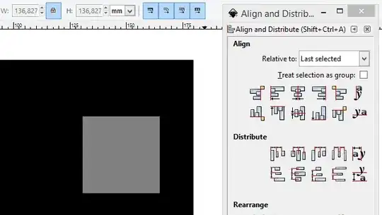

I have used another method. Once i got used to it, and learned how to use the snapping options, I find that I could work pretty fast. This works best with paths composed by orthogonal lines that are parallel to the axis.
  1. Subtract a circle having the radius you want from a square to create a 'cutter' shape. Put the centre of the circle on one of the square corners and size the square as the circle diametre. This ensures that the centre of your cutter will be aligned with the arc edges:
  2. Duplicate your cutter to be able to reuse it and align it put it on the corner that you want to round. Activate snapping of centres of objects and cusp nodes to align the cutter exactly where you want. enter image description here
  3. If necessary, rotate the cutter along its centre to align the arc with the edges of the underlying path
  4. Select the original path and the cutter and do a boolean difference, if your corner is convex, a boolean union if it is concave. Your corner is now rounded!
  5. Duplicate the cutter and repeat for all the corners you wish.

Another solution to this problem is to use the path division tool. The advantage here is that the radii can be explicitly set as a number
  1. Create the rectangle
  2. Create a circle with the desired radius
  3. Align the circle into the corner of the rectangle
  4. Select the rectangle and the circle, and use Path-> Division
  5. Delete the unwanted corner piece
  6. Do a Path-> Union between the new circle and the original rectangle

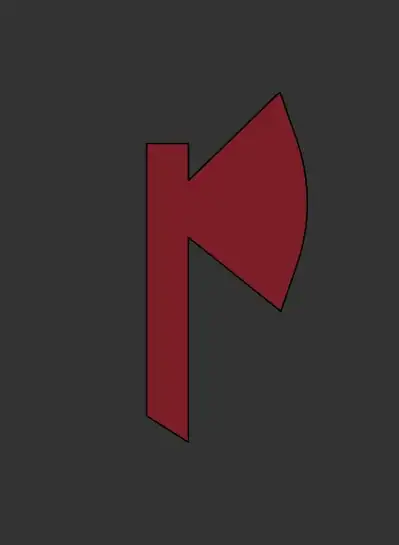

I've had success with just using Bezier curves. E.g. I would draw the OP's L shape like
   \_________
(very rough ASCII art!) i.e. with a diagonal line where the rounded corner should be, and then adjust the Bezier control points for the two line join points.

It's very simple actually.
  1. Make a shape that has rectangular corners.
  2. Click on the rectangle tool
  3. Click on one of the circular handles at a corner of the shape, not one of the square handles.
  4. Press Shift and drag the circular handle, it will automatically make rounded corners.
Drag a circular handle to make rounded corners.
karel
  • 13,488
    Unless this changed recently, this should only work for plain rectangles, which is not what the question is about. Even your screenshot shows that you are only selecting the rectangle that constitutes the left part of the shape. Finally, your screenshot does not exhibit the requested inward rounding of concave corners. – Wrzlprmft Jun 19 '16 at 19:03
