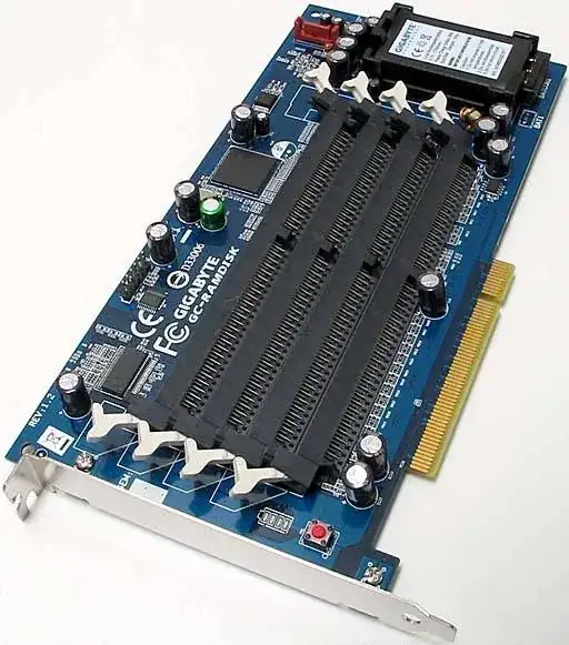

Regarding DRAM-based mass storage devices: take a look at Gigabyte i-RAM (note the rechargeable Li-Ion battery, which makes it non-volatile for a while)
(source: techreport.com)

To answer the question- It does not!
Non-volatile random-access memory From Wikipedia, the free encyclopedia Non-volatile random-access memory (NVRAM) is random-access memory that retains its information when power is turned off (non-volatile). This is in contrast to dynamic random-access memory (DRAM) and static random-access memory (SRAM), which both maintain data only for as long as power is applied. The best-known form of NVRAM memory today is flash memory. Some drawbacks to flash memory include the requirement to write it in larger blocks than many computers can automatically address, and the relatively limited longevity of flash memory due to its finite number of write-erase cycles (most consumer flash products at the time of writing can withstand only around 100,000 rewrites before memory begins to deteriorate). Another drawback is the performance limitations preventing flash from matching the response times and, in some cases, the random addressability offered by traditional forms of RAM. Several newer technologies are attempting to replace flash in certain roles, and some even claim to be a truly universal memory, offering the performance of the best SRAM devices with the non-volatility of flash. To date these alternatives have not yet become mainstream.
Source: NVRAM wiki page
