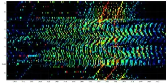

Here is a blog post from one of the guys over at serverfault. They took a frequency analyzer, and looked at how various other 2.4 GHz devices (like microwaves and baby monitors) affect the Wifi spectrum.
This is what they found the Wifi spectrum to look like normally:
Normal wifi spectrum
Those diagonal lines are the Wifi broadcast. There is almost no interference, so they are clear and easy to see.
This is what that same connection looks like with a typical microwave on:
with microwave on
As you can see, the microwave causes some serious interference.

I have found microwaves to interfere strongest on channel 9 or so (which you can see in the photo, the microwave blasts the whole band pretty well but is strongest towards the top of the band.) If in N mode the access point tries to use a wider channel, it's almost impossible to avoid noise versus a 20mhz channel. You might be able to run N but restrict it to 20mhz instead of automatic channel width.
