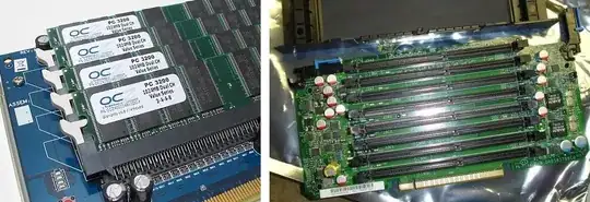

Having said that: Yes, RAM disks do exist. Even as PCI board with DIMM sockets and as appliances for very high IOps. (Mostly used in corporate databases before SSD's became an option). These things are not cheap though.
Here are two examples of low-end RAM disk cards which made it into production:

  • Actually, the I-RAM device was massively cheaper than the EasyCo one - but sadly no longer available. Nor is its successor the GC-Ramdrive. – symcbean Aug 27 '13 at 21:20
  • That is how old I-ram idea is. Max 4 GB of 3200 DDR2 ram at a max 1.5 SATA I rate performance. Fast, but we have cheaper DDR 3 memory now. – Carl B Aug 28 '13 at 04:09

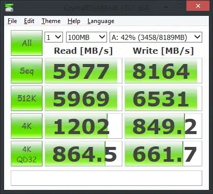

I do all my immediate read/write operations for content generation in RAM disks on my local machine. I also store my MongoDB journaling folders there, as well as my compilers and Python interpreters and standard library. This disk is saved on shut down and restored on start. The second RAM disk I use is 64 megabytes and all my internet browser's cache folders point there; that one is lost on shut down, and flushes itself when it's full.
Use the right tools for the job I suppose, would be the answer I give you. I'm generating data 30-1000x faster using a RAM disk than on my 7200rpm Western Digital.
This is the program I'm using: http://www.romexsoftware.com/en-us/primo-ramdisk/
...and when 32gigs of Ram is less than $200, I don't see why this isn't becoming more common.
8 gig RAM diskeveryday SATA III HDD

    You know that the OS caches things for you already, right? – Potatoswatter Aug 28 '13 at 09:44
  • "when 32gigs of Ram is less than $200" 32 GB on a 1 TB HDD starts out at around $3, give or take; consumer 1 TB drives go for less than $100 today, and even enterprise grade drives can be had for similar per-gigabyte prices (Amazon wants $408 currently for the 4 TB Seagate ST4000NM0043 which sports a RRP of $520, and that's single units without even shopping around). – user Aug 28 '13 at 09:52
    @Potatoswatter yeah, it does. But it doesn't cache 10,000 newly created files. So, I explicitly "cache" them on my RAM disk. – blakev Aug 29 '13 at 17:36

As others have said RAM is volatile and something like 10x the cost of SSDs.
However, there IS a product out there that comes pretty close to what you're describing--unfortunately I can't recall the name.
What it is is RAM-based drive (IIRC max 64gb) coupled with a CF card and a battery. When you turn the system on it copies the contents of the CF card to the RAM (I believe serving requests from the CF card if they haven't yet been loaded.) On shutdown the contents of the RAM are copied to the CF card--the battery is big enough to permit this to finish before it's depleted.
It's not cheap.
