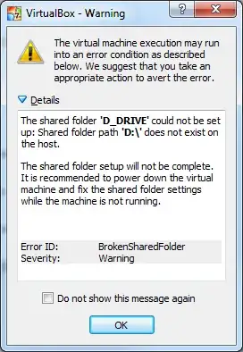

  3. If you had shared folders in the original VM, they may differ and you will get error. Review those in Settings >> Shared Folder and delete the ones which are broken. An error message will look like
