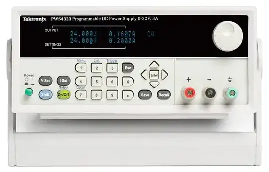

Going Star Trek...
It would be ideal to use a professional, digital, programmable, DC power supply. This type of device is used for equipment testing, and as they are very advanced, precise and programmable, they can be used to charge any laptop you want (and more).
Here is an example of a Tektronix PWS4323:
tektronix psw4323
This is obviously an overkill! It's not something for the average Joe. But for every problem, man has created a solution! Chances are that this little baby costs probably more than your laptop alone. MSRP: $904
