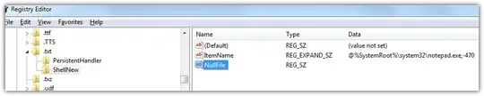

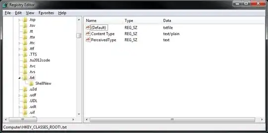

Here are two screenshots of what the final outcome should be:
Enter image description here

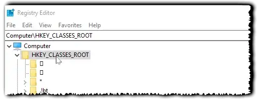

1. Click on HKEY_CLASSES_ROOT and look for a .txt in regedit.exe
2. Do export and (keep a copy as a backup) and copy paste the following code.
3. Finally import it as .txt . That's it. It works for me on Windows 10.

Removing Unwanted Context Items That Block New Text Document Entry
As explained in some of the other answers, Windows only allows a certain number of items in the right click New menu. So even if you have the .txt registry correct (as explained in the other answers), you may not see the Text Document entry in the New menu. Here's how to delete the extra entries.
  1. Open Regedit.
  2. Click the File -> Export -> All. Click Save to make a backup of your registry in case anything goes wrong. enter image description here
  3. Navigate to Computer\HKEY_CLASSES_ROOT
  4. Press CTRL-F to Search and type in ShellNew. enter image description here
  5. Press F3 or Click Find Next.
  6. When it stops on a "ShellNew" key, check the contents of the value ItemName (or it may be named command or FileName)
  1. If the path shown is not for a file type you want in the context menu, delete the corresponding "ShellNew". Don't Delete any Keys which are not named simply "ShellNew".
  1. Repeat 5-7 until you have deleted all the other unwanted ShellNew entries.
  2. Check Your Context Menu To Verify .Txt Shows UP.
  3. On Windows 10, you should be able to see the changes immediately, if not, try restarting the Windows shell using Task Manager: enter image description here
  4. Test by right clicking in a folder you have permissions too (like the Documents folder). If you don't have permissions (e.g., in the root c:\ directory) you will see little if anything in the New menu. enter image description here
