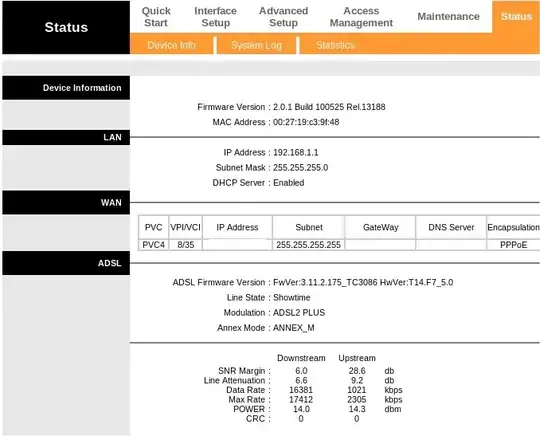

Caught the restart values in the image below
  • SNR margin downstream is negative (-5.-1)?
  • CRC 2014
My tech support is telling me they will call the national telephone agency to check out the signal.

Problem solved: the signal was too weak, my ISP boosted the signal.
SNR margin downstream is now around 22dB.
