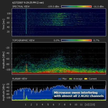

If you ever get your hands on a spectrum analyzer (some high end ubiquity wireless bridges have software spectrum analyzers built in), turn on a microwave and then look at the wave patterns. You will see the microwave absolutely drowning out the access point. http://www.ekahau.com/userData/ekahau/wifi-design/screenshots/spectrum-analyzer-big_microwave_oven.png

The baby monitor will not show up on normal software because they do not broadcast an SSID. (Other than the fact that your noise floor will be way higher). They will show up in spectrum analyzers.

The honest answer is that in complicated interference environments, even the best RF/802.11/network engineers can't always predict—with any accuracy—which channel will perform best. Part of that is because some 802.11 radio designs deal with different types of interference better than others.
If you don't have a spectrum analyzer you can't see non-WiFi users of the 2.4GHz band, and even if you do, unless it's clear that one channel is dramatically cleaner than the other channels, it's hard to know how your particular devices will perform.
