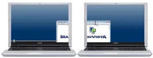

Commercial solution ($39.95) :
If you have another computer, for example, a laptop, you can use it as second monitor by using:
MaxiVista
MaxiVista turns any spare Desktop, Laptop or Netbook PC into a dual monitor for your primary computer. No extra multi monitor hardware is required. Simply extend program windows across multiple screens as if it were one big monitor. Increase your productivity by using multiple monitors.
See this article for a detailed description:
Add multiple monitors without additional video cards using MaxiVista
