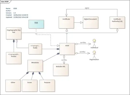

The whole subject area is bamboozling. Several reasons for this:
  1. Lack of understanding of what an RSA key is. Most examples start with creating a private key. You end up wondering, "So, where is the public key?" Read this: https://security.stackexchange.com/questions/172274/can-i-get-a-public-key-from-an-rsa-private-key
  2. Next, is all the PEM, JKS, PCKS12 etc. Would drive anyone mental understanding what the heck these are and how they are interchanged? They are different formats for storing keys and certificates. Don't stress. Have a beer and relax now. Okay...download an ancient tool called: portecle its French for door key. Its a Java app and a Swing UI which is from the ice age...but it works and allows you to look inside different types of files, and to also use it to change JKS files to other formats and vice versa (but not all...see later)
  3. Next...the next thing that is going to really drive you mental, is that portecle does not for example open a PEM file containing a cert or key or both. So, you start banging your head against the desk, you squeeze the hampster just a little too much, and then you discover: openssl and you wonder where the heck to get that from...well, download Git, and make sure you get the console that comes wif it: enter image description here Right. Now you have access to openssl. Meanwhile you have aged a few years. The latter command comes with gitbash. It allows you to look at a PEM file internals...god help you with that one too...cause the verbosity is just mind blowing. Instead just use cat [yourfilenamehere].pem to look at the internals of a file, later lookup openssl commands
  4. Now, you have to understand the difference between a key and a certificate, for that you can look at this diagram: enter image description here You now understand why a key is just a key (part of a cypher key pair) and encoded in base64, and why a certificate is what it is (oh before i forget, -des3 is an encryption switch for creating a key...there is about a zillion of them too...hahahaha...take a Tylenol...)
  5. Good. Finally, take this brilliant example, and write a localhost integration test, to try it all out for yourself: https://www.section.io/engineering-education/how-to-get-ssl-https-for-localhost/
  6. It has taken me, from scratch on and off about 10 days to try to wrap my brain around it all. Don't forget, you can sign a certificate with a private key. That is what a CA is for. Anyway, enough of my vernacular...I sincerely hope this helps!
  7. Oh and get this right, in the above brilliant example, you can see, that simply adding a CA.pem to your browser (the one you created to self sign a server certificate) can just do away with ANY security issues, when reaching out to localhost...security my derrier...that is French for ;=)
Beezer
  • 101
  • So, if you have a .pem file with a private key, you don't need to specify a public key, right? It sometimes confuses me, and I end up with the question of if I need to add a BEGIN PUBLIC KEY/END PUBLIC KEY statement. With theCERTIFICATE and PRIVATE KEY statements is enough right? – S. Dre Feb 27 '23 at 14:59
  • The PEM file is an instance of an .X509 certificate that vouches for a person or organization, and includes the public key of that person or organization. The latter certificate is then "signed" by a CA certificate to vouch for its authenticity. Therefore the PEM does not include the private key. That key is private to the person or organization. When a message intended for the person is encrypted with their Cert public key, they can then decrpyt it, after receipt. – Beezer Mar 19 '23 at 19:15
