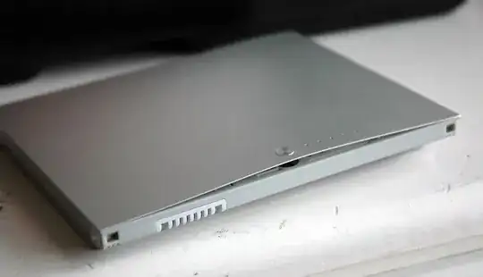

This is one of the problems of leaving a laptop battery running on AC all the time: enter image description here
It either swells, or it just looses its ability to run off of batter for more than a minute or two. Run on AC only if you want to preserve the battery.

    @AthomSfere, I don't understand your image. Where is the swelling part? Do you have a non-swelling image for comparison? – Pacerier Dec 23 '14 at 19:21
