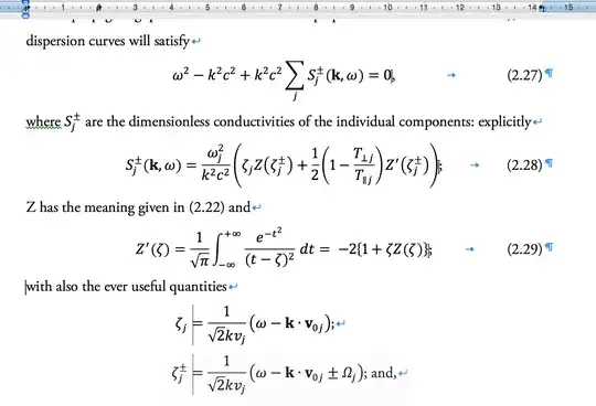

This is a perennial question so I hope you will not mind me submitting another answer.
The problem with the "table" approach is that it breaks the paragraph. This can cause spacing issues if your equation is part of a continuous sentence and your paragraphs have spacing before or after them. It also means that wrapping is done rather poorly for long equations (the usual preference in journals is that, if the equation is the width of the column, the number should appear below the equation right aligned instead of breaking the equation). Finally it does nothing to solve the problem that you wish to have punctuation marks instantly after your Display equation in the normal paragraph font.
My solution is to insert a style separator instantly after the equation. On Windows, use Ctrl-Alt-Enter to insert a style separator. (On a Mac this is not available, but if you open a document created in the Windows version of Word you can copy the style separator into Mac). Then you may insert a tab (with a final right-aligned tab stop already created) and the appropriate equation number autotext. After the equation number you should insert a full paragraph break and not a line break, but at least in Word 2012 the paragraph break is treated as though it were a line break for layout purposes. This may be a bug.
If you want your equations neatly aligned at the equals sign, this is, to my knowledge not possible using this work-around. One way around this is to write your punctuation inside the equations, inside double quotation marks. The Equation tool converts this into free form text which may be placed in whichever font you prefer. I also use this method when I want several small display equations on one line separated by commas or the expression ", and ". However, you cannot number these equations, or at least you can only number the final equation in the set.
The result, with hidden paragraph marks on, looks something like this. Microsoft Word 2012 some equations
[Note I have also changed the default behaviour of line breaks in fully justified text so that the final line before the line break is not fully justified.]
The style separators here are the thin dotted lines at the end of equations (2.27)–(2.29). Mac Word does not have the proper glyphs to display style separators with a proper picture as you would find in Word for Windows.
Inserting a line break instead of a paragraph break after the equation number seems to cause buggy layout behaviour on my machine.
Unfortunately the end of the sentence after your equation, on the new line, looks as though it is a fresh sentence to the spelling and grammar checker, probably because of the paragraph mark. I have accepted this and resorted to using "ignore" very frequently.
There is a final caveat: when referring to the equations later, the tab before the equation seems to show up with the reference number. You can avoid this by giving an explicit field switch of the form \#(0.0x);(0.0x).
I have been using this approach in a document I am writing which is now up to 160 pages containing a few hundred equations so I think it is relatively robust, once you get it to work.

    I like this answer. Could you please expand on pagaraph 3? I.e., how do you enter a style separator (a link is OK), etc? Just so that the answer is more self-contained. – Leo Nov 17 '15 at 16:55
  • @Leo On Word for Windows, Ctrl-Alt-Enter. You cannot insert one on Mac, at least not on the pre-2015 version of Word. However if you open a document that already contains a Style Separator, you can copy and paste it and use it on a Mac as normal. – Calchas Nov 17 '15 at 16:58
    Thanks, Calchas. I was able to insert the Style Separator, which in Word 2013 looks like the Paragraph sign in a little dotted box. But I was unable to get the rest of the recipe to work. The characters typed don't seem to go anywhere unless I type another enter, which then sends them to the next page. – Leo Nov 18 '15 at 02:44
    Huge thanks for the style separator hint! I am fed up with being unable to add a comma or a period after the displayed equation. – texnic Nov 29 '15 at 11:44
    It's a great technique. Unfortunately, I couldn't make it work in Office 2016. If I insert a Tab after the style separator, the insertion point goes outside of paper margin. If I type something after such Tab, I can see the text in the Draft View, but there is nothing visible on the Print Layout. Adding Tab stops doesn't help. Is there any secret? – facetus Oct 18 '17 at 21:19

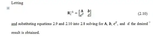

This solution does not take care of automatic labeling and assigning captions, however, I believe it will be quite useful to people looking at this thread. Adding a number to an equation is way more simple than what the existing answers suggest. All you need to do is append the equation with a #label, for example:
x + 1 = y #(1)
will get rendered as x+1=y with (1) on the right (See the picture).
For more documentation on MS Word Equations I recommend http://www.unicode.org/notes/tn28/UTN28-PlainTextMath-v2.pdf, it is an extremely useful document!
The screenshot is taken in MS Office 2016 but the document itself is from 2006 so I expect this works for sure in MS Word 2007 and newer.
