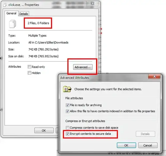

With Total Commander, you can do a search (ALT+F7) on various attributes of files and folders.
The "encrypted" attribute is one of them.
alt text
Once you have found all encrypted files and folders, select "Feed to listbox". It will put all names in the selected pane (left or right). There, you can select them all, right-click and select Properties. You'll get the Properties window for all the selected files. In the Advanced window, you can easily decrypt them by unchecking the "Encrypt..." checkbox.
alt text

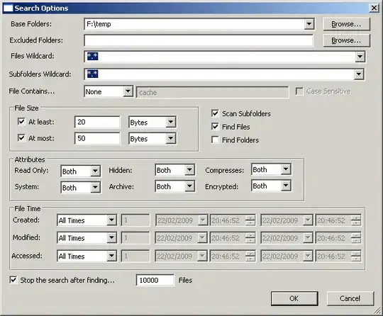

After trying Total Commander and having it fail for some inexplicable reason, I tried NirSoft's SearchMyFiles and it worked excellently. Lightweight standalone executable and the results don't have cruft to wade through like the cipher command; you can easily sort by folder path to know what listings are merely subdirectories of a parent encrypted folder.
SearchMyFiles
SearchMyFiles Search Options
