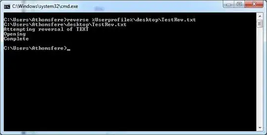

I thought I would add this as a second approach, as it might work better for some:
If you are open to something you can call, instead of batch logic:
This is a .NET application that you drop to %Systemroot% and call just like any other command in a batch, .bat, .cmd etc.1
Usage looks like: Reverse "C:\Path\File.txt" enter image description here
And, yes, I own the thing. It seems easier to me to call this than write the logic out. It will replace the file contents, at present at least and not create a second file.
