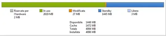

I have windows 7 professional 64bit with 4GB of RAM.
It displays in System Properties 4GB installed and in Resource Monitor correctly shows 4096MB and 2MB reserved for HW.
The bios shows 4096MB and the overlapped memory is on. Motherboard is ASUS p7p55d-e.
The OS uses only 3.1 GB ram as if it was a 32-bit os. Why?
Tried changing bios configuration regardless and set windows boot option to use /not use Max memory and so on....
BUT I still have the limit of 3.1GB RAM max allocated.
Can someone help me?
Maybe the OS installation is corrupted? Some new update? Or something else software/OS related? Or... I don't know....

PICTURE:
The peak is 3.5 / 3.6 GB
ram graph - peak is 3.5/3.6 GB
PICTURE 2 Monitor Resource (IT lang)
from left to right in the legend:
  • Reserverd (gray)
  • Used (green)
  • Modified (orange)
  • StandBy (blue)
  • Free (light blue)
mon_mem
P.S.
My question is not related with the others one tagged, because it's a differnt problem:
It is no BIOS related, neither some "Advanced Boot Option in the OS".
otherwise I've not 4 GB Tot ram available (see Pic.2)
thx for help.

    Wait a minute. The title says x64 so 64-bit, but the question says the OS ... is a 32bit os. Please double-check the system properties (Win + Pause, or Control Panel - System); is your installed OS 32-bit or 64-bit? If it's actually 32-bit, that would perfectly explain what you are seeing. – user Mar 25 '13 at 12:28
    @MichaelKjörling I think he meant to say The OS uses only 3.1 GB of RAM as if* it was a 32-bit OS* – ta.speot.is Mar 25 '13 at 12:30
  • @ta.speot.is I think it's worth getting clarification on. – user Mar 25 '13 at 12:32
    Where do you get the information that the OS only uses 3.1GB ram? (Perhaps provide a screenshot so we can prove you wrong) – Alvin Wong Mar 25 '13 at 12:32
  • [update question: yes i'm using x64 os, and monitor ram with SysInternal process explorer]
    Maybe it's somenthing related with Power Saving too?
    – Raffaello Mar 25 '13 at 13:02
  • You have enough rep so now you can post the screenshot :) – Little Helper Mar 25 '13 at 13:15

  • @Raffaello According to the screenshots you have 4 GB of RAM available, and are currently using ca. 2.4-2.6 GB of it. I can't see anything that suggests that your computer "uses only 3.1 GB ram" or "the ram peak it's at 3.5/3.6 GB". Where are you getting those numbers from? What processes are running at that time? What are you doing to ensure that the computer uses as much RAM as possible? – Indrek Mar 25 '13 at 22:03

I don't see a problem. Your 2nd Picture is showing 4GB of RAM installed. 2.6GB is being actively used and 1.4GB is standby RAM which is like a cache for old/pending data/files that costs very little to keep around but can be freed up if an active application needs it. This is normal and by having standby data it makes your system faster as its not disk bound all the time.
Just because your peak usages of 3.1GB/3.6GB does not mean that you only have 4GB. The system is reporting that the applications are not filling the RAM and its using the rest for cache. Which is great. 8GB in that system might be overkill.

  • my peek usage was 3.1 before ran the bcdedit command line, after it was on 3.5 / 3.6 GB. Testing with mem opt that alloc all available memory. Yeah, maybe it's memory optimizer too fault. :) thx – Raffaello Mar 25 '13 at 14:17
