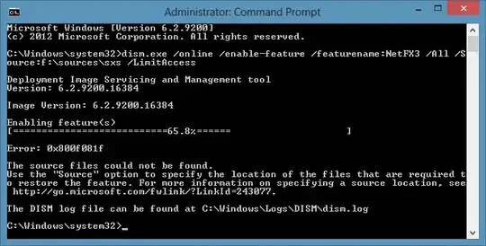

I am using Windows 8 x64 and would like to install the .NET Framework 3.5. I've downloaded the full package dotnetfx35 from http://www.microsoft.com/en-us/download/details.aspx?id=25150. Installation fails with Error: 0x800f081f the source files could not be found.
Regression:
How can I install .NET Framework 3.5 on Windows 8?
  • Are you sure that the F drive is where iso is mounted? Double check in Explorer an make sure you're pointing the /Source option to the correct location. – Windos Mar 24 '13 at 20:44
  • yes, I'm dead sure about it – Mohammad Dayyan Mar 24 '13 at 20:45
    What iso are you using and where did you get it from? – Windos Mar 24 '13 at 21:21
  • If you can access Windows Update, you can install it through the Control Panel as described in http://msdn.microsoft.com/en-us/library/hh506443.aspx – David Marshall Mar 24 '13 at 22:47
  • @DavidMarshall I don't agree with your statement that when you can access Windows Update, that .NET Framework 3.5 can be installed through the Control Panel. In our case the "Control Panel" method returns the 0x800f081f error code where the dism.exe /online /enable-feature /featurename:NetFX3 /All /Source:D:\sources\sxs /LimitAccess command and a newer 8.1 DVD does result in a successful installation of the .NET Framework 3.5. – Pro Backup Apr 05 '14 at 18:52
Download the Enterprise Evaluation ISO, mount it and now point to this ISO. This ISO includes the SxS folder.

  • And make sure that you don't make any typos in the dism.exe command. I for example mistyped a lower case x (/featurename:NetFx3) instead of the required upper case X (/featurename:NetFX3). – Pro Backup Apr 05 '14 at 18:46

Uninstall the security updates KB2966826 and KB2966828 and then install framework from the control panel/ program and features/ turn windows features on
