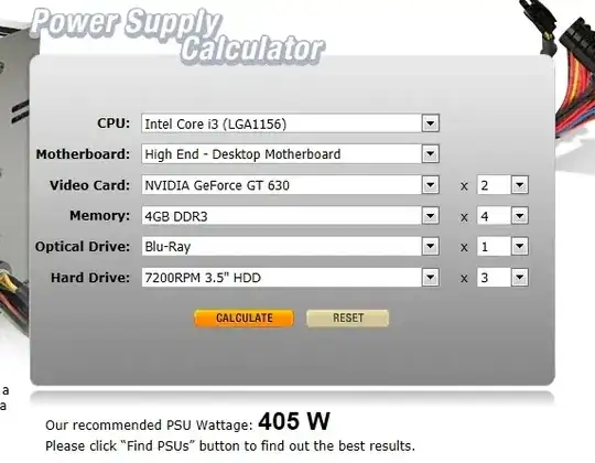

Here you go, I use this myself:
Power Supply Calculator
With the data you supplied (and I added 2 7200rpm drives and 2 of your vid cards) you shoould be good with your 450 watt PSU.
If your system grows, you are nearing the limit and you may need to upgrade if you add more items. This was figured with PSU calc newegg and you can add or remove comonents to see what the Watts needed will be.
psu results
