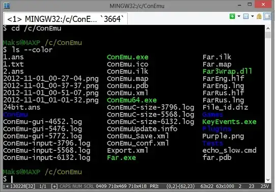

Seems to me, your question is incorrect. You need to enable color in your console application, but not in ConEmu, because it is terminal, but not a shell. Refer to your shell/application manuals. For example, ls has special switch.
ls --color
There are also ANSI sequences, ConEmu supports them - you must enable two options (ATM they are on the Features page of Settings dialog)
  • Inject ConEmuHk
  • ANSI X3.64
Enabling colors in ConEmu
Of course, your application must be able to output ANSI codes to console. If they not - ConEmu can't do anything with them, because it is terminal, but not a shell.
Maximus
  • 20,745
  • I Thanks a lot for your time and helping out of this confusion. – Vivek Kumar Mar 07 '13 at 06:55
  • This post is very helpful, but I still can't get mine to work. I've tried with cmd.exe as the underlying shell in the startup section, as well as zsh for windows and tccle.exe but when I execute "ls --color" provided by Gnuwin 32's coreutils package I just get ansi escape codes in the output. Even when I use the Git Bash console I just get ansi codes (whereas git commands via sh.exe show color). Any idea why? – Sridhar Sarnobat Oct 08 '13 at 19:21
  • @Sridhar-Sarnobat if you get raw ansi escape codes, why not to enable them in ConEmu? wiki – Maximus Oct 08 '13 at 21:04
  • Appearance -> ANSI X3.64 / xterm 256 colors was already checked, and so was Miscellaneous Options -> Inject ConEmuHk. But I still get escape codes in the output. Is there soemthing else I need to do? – Sridhar Sarnobat Oct 08 '13 at 21:22
  • Update to preview build at least. – Maximus Oct 09 '13 at 05:04

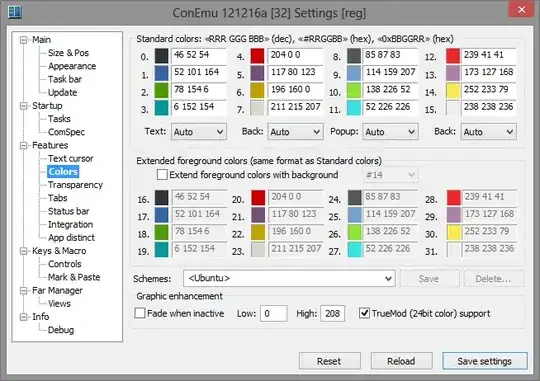

Have you looked in the Options dialog.
Brad Patton
  • 10,600
    Yes I tried that earlier too.
    I am looking for something like for example, dir are in different color if I press ls command
    – Vivek Kumar Mar 06 '13 at 16:07
  • The color scemes are important if you see wrong colors, e.g. the green is displayed as red/yellow. I also prefer style. – Gábor Imre Jun 03 '15 at 10:56
  • yeah I thought it wasn't working - and then I went to this page and changed to another scheme. The default conemu hides my coloring for some reaosn. – Mikey Jan 20 '19 at 13:27
  • the ubuntu scheme is nice for example – Mikey Jan 20 '19 at 13:40
