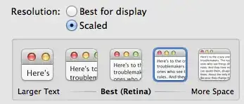

If Window/Zoom option from menu won't help (as suggested in 1st answer):
Window/Zoom on OSX
(this could happen when application has it's own non-standard implementation of the Window menu like Adobe Photoshop),
you've to go to Displays Settings and select 'More Space' (Scaled) option.
See:
Displays - Scaled - More Space
If you'd like to have some permanent solution, please install BetterTouchTool, which provides extra options (gestures) for moving the windows. In example:
BetterTouchTool - Move windows
kenorb
  • 25,417
    My resolution on my monitors were already maxed out , but setting from 'Best' to 'More Space' and then setting it back to default made the Filezilla window end up as full screen on my Macbook Pro screen – DemiSheep Oct 22 '15 at 17:00
    The scaling + option-drag-window-edge worked for me. – Jorge Orpinel Pérez Nov 25 '15 at 21:53
