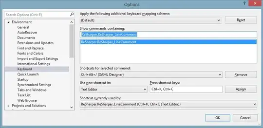

If you have ReSharper installed (and using VS without it is/was tedious), you can assign a single key to the command ReSharper.ReSharper_LineComment.
For instance, I bind the keyboard shortcut Ctrl-K, Ctrl-C to the command, and then if I use it on a line that is uncommented, it comments it, and if the line is commented, it will uncomment it.
    so to directly answer the original question, assign CTRL + / to ReSharper.ReSharper_LineComment – Chin Mar 09 '16 at 01:59

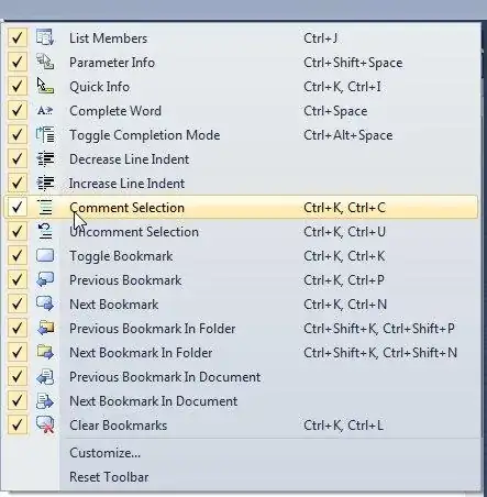

Ctrl-K and Ctrl-C will comment one or more selected lines.
Ctrl-K and Ctrl-U will uncomment one or more selected lines.
You can get toolbar icons that will do this by adding the "Text Editor" toolbar. In the toolbar area right-click and select "Text Editor" This will add a strip of icon buttons like this:
You can customize this strip by selecting the dropdown at the end of the ribbon:
To edit the keyboard combination go to Tools-Options and select Keyboard under the Environment tree. Here you can change the keys used to trigger the Comment and Uncomment actions:
