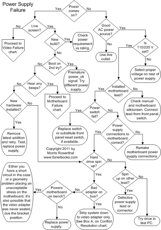

Here's a great flowchart on diagnosing power supply problems. The guy's selling a book full of similar hardware troubleshooting flowcharts with solid discussion of what's going on. There are several available at the link for perusal. These are basic component-level troubleshooting charts, and don't get into tearing down the power supply to fix it, but these are all the basics in one reference:
Flowchart for ATX Power Supply Repair, Morris Rosenthal, www.fonerbooks.com
