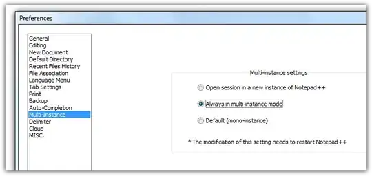

Since Notepad++ v6.4.3 a new option was added which enables multi instances:
Enter image description here

    Wanted to add that in Windows 10, after you've enabled the multi-inst, you can right click the notepad++ icon in the taskbar and hit notepad++ to open new window. Took me a second to figure it out, so wanted to share. – John Lee Aug 22 '18 at 17:58
