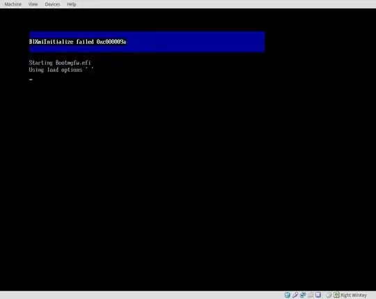

The next hitch is EFI. I enabled EFI booting in VirtualBox, but whenever I boot the EFI/Microsoft/Boot/bootmgfw.efi image, I see the following code:
BlXmiInitialize failed 0xc000009a
boot error
and it doesn't boot. Plus, having to use the actual UEFI shell to get things booting is at best a hassle.

According to members of the VirtualBox team and according to the VirtualBox manual:
Note that the VirtualBox EFI support is experimental and will be enhanced as EFI matures and becomes more widespread. While Mac OS X and Linux guests are known to work fine, Windows guests are currently unable to boot with the VirtualBox EFI implementation.
It's pretty lame, but true. Interestingly enough, it'd be arguably more difficult to implement EFI for Mac OSX than for Windows, as basically every modern motherboard has UEFI firmware that "just works™" with Windows, whereas Apple uses their own proprietary EFI implementation designed for their own hardware.
TL;DR: As of the writing of this post, EFI support doesn't really work with Windows in VirtualBox.
