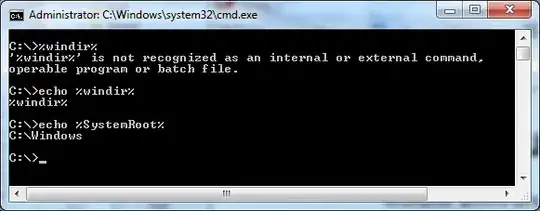

My computer (Windows 7 x64, Lenovo Thinkpad T530) is having an issue resolving %windir%. After boot-up, everything works fine. At some point a while later, the computer is suddenly unable to resolve %windir%.
Console Window

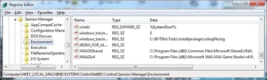

Checking the registry also shows that it is defined as well. I've actually deleted the key and re-entered it to no avail.
Registry

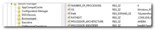

Update 3: Per Daniel in the comments, I ran set before and after error and compared the outputs. The first thing I noticed is that on a fresh boot my %path% is 2000+ characters long. I pruned it down to ~375 characters and verified it in a new cmd window. I rebooted, checked the path again, and it was back to over 2000+ characters (it matched what I originally saw). I truncated it again and rebooted once more and the same thing happened. I deleted the path variable and created a new one; same thing happened. At this point all I can conclude is either I cannot permanently change my path OR the path is being reset by some process on boot. Any thoughts?
Update 4: I edited my path via the registry method suggested below. I checked my path today after running for a while and it has grown from what I entered into the registry; it now has a few new entries and a lot of duplicates. The only new entries are from SQL Server 2012. I went to change this in the registry and I noticed that the registry does NOT match the output of echo %path%. Checking the Environment Variables from the Advanced Properties Tab shows a third version of my path.
Registry Path:

It looks as though the command line path = registry path + environment variables path. I attempted to set the registry path and the environment variables path to the same thing and reboot. After reboot, my path is now doubled, basically two back-to-back copies of the registry path above.

  • try to use set to assign value to windir manually and repeat with echo again - see if this will give you output or not. If it will then something is messing up with your env variables - if not then something is not ok with your shell and/or echo command. – mnmnc Jan 03 '13 at 19:41
  • Setting it works, but I'm not really sure that that proves anything, as I can run "set SystemRoot=abcd", for a similar, short-lived session variable – Zack Jan 03 '13 at 19:50

Summary of the solution: make sure your path is < 2048 characters. Check in both the user variables and the system variables.
With the GUI, set your %windir% variable content to %SystemRoot%.
As for your %path%, you may solve this with Registry Editor:
  • Start Regedit.exe
  • Go to HKEY_LOCAL_MACHINE\SYSTEM\CurrentControlSet\Control\Session Manager\Environment
  • In the right pane, double-click on the value Path (REG_EXPAND_SZ)
  • Change the value however you like and reboot

I did have the same problem in my Lenovo TS530. It started to occur after installing new programs that caused my path to be even much longer than before and so that the installers added the new stuff into the beginning of path definition. I edited the path in regedt by moving %SystemRoot% into the beginning of the path definition.
path = %SystemRoot%\system32;%SystemRoot%;%SystemRoot....
In addition, I edited enviromental variable windir from
windir= C:/Windows
to
windir=C:\Windows
That seems to have fixed the problem. (It is possible that I did the mistake with backslash earlier while trying to fix the problem. Or alternatively the installer has changed it.)
