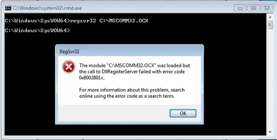

I want to use MSCOMM control in my MS Excel 2010 VBA. The control shall appear in Tools-> Additional Controls dialog box in VBE of MS Excel 2010.
I am trying to register MSCOMM32.OCX on my 64-bit Windows 7 machine. However, as I try to register it using regsvr32 as shown in the command window below, I am getting shown error popup.
What am I missing here? Why is this component not getting registered?
Or this is not the correct way to include MSCOMM control in MS Excel VBA?

  • @Jay - Its also a 32-bit module which cannot be loaded into a 64-bit process. You are likely using 64-bit version of Excel if your getting this error. – Ramhound Nov 28 '12 at 05:04
Put your ocx control to C:\Windows\SysWOW64 and try to re-register it in that location with the 32 bit regsvr32:
C:\Windows\SysWOW64\regsvr32 C:\Windows\SysWOW64\MSCOMM32.ocx
If it doesn't work: you could try to pick a different version. you could also check if it has all its dependencies already installed.

    @jay, did you copy the whole command line? Salaros is advising you to also use the 32 bit version of regserver. – SeanC Nov 26 '12 at 12:24
    The CMD prompt needs explicitly to be started with "Run as Administrator" and full paths used to make absolutely sure that the 32 bit versions are used. And, of course, it will only work with the 32-bit version of Excel. – Tonny Sep 05 '13 at 09:22
