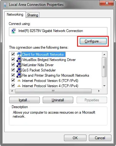

Go into properties for Network Connection. Click "Configure" next to desired network adapter and on Advanced tab you should have one field for MAC address. Usually it is named "Address", "Locally Administered Address" or something similar. There you have text box in which you can type desired MAC.
