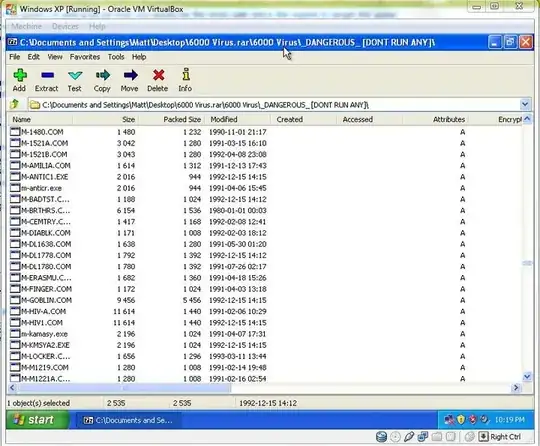

    If in VirtualBox you have no shared folders or use any of the device features and if you want to be even more sure, look at the bottom of the VirtualBox window:
    the picture, right at the bottom near the 2 computers icon switch it to not connected
    You should be able to run any viruses and not get one on the host machine, although to be sure, keep antivirus software running.
