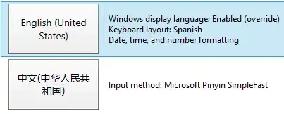

I have a Spanish keyboard on my notebook, but I use it mostly for English and Chinese writing.
This is how I configured the languages:
Language preferences

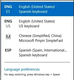

However, Windows added some layouts on its own (probably when connecting via Remote Desktop to computers with different languages/layouts):
Available layouts
Those layouts are all part of the AltShift cycle, which is extremely annoying.
How can I remove ENG/US and ESP, considering they don't show in the configuration list?
Is there a way to prevent them from being added again?

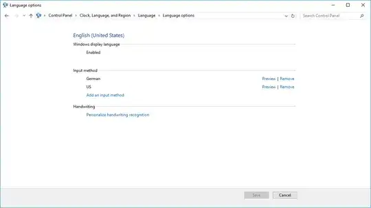

On Windows 10, you can remove keyboard inputs / layouts here:
  • Control Panel → Clock, Language, and Region → Language → Language options
If you have multiple display languages installed (let's say "English" & "German", then you need to check your keyboard inputs for each language).
Screenshot:
    this addresses the regualar way of adding/removing keyboards in windows - the asker states that they arent listed there – BobbyTables Feb 22 '18 at 17:29
