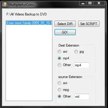

Another solution for Windows I just found for those who don't want to have to deal with a ton of scripting:
Convert and Date Preserve
Once you download it, the program itself is located in MultipleAviConvDatePreserve\bin\Release\MultipleAviConvDatePreserve.exe
And you can use it with any converter that allows command-line (such as handbrake). Not the easiest program to use, but easier than the posted solution.

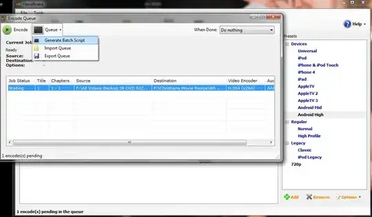

Because I had some trouble getting the program to work myself, I thought some specific directions on how to use the program might be helpful.
Open Handbrake (or some command-line enabled video encoder) and setup a file for encode like you normally would (with all the preferences you want) and then add it to the queue. Then open the queue and click the "Queue" button and "Generate Batch Script" as shown in the screen shot below:
Generate Batch Script Then open the batch script in notepad and copy the contents (we will use it later). Next open up MultipleAviConvDatePreserve.exe And click the "Set SCRIPT" button Set SCRIPT
Then paste the contents of the batch script generated by Handbrake into the script text box but replace the source and destination in the script to %source and %dest: Enter script
I couldn't get the RunAsDate.exe to work, but you can try it out - it supposedly makes it so the system date doesn't need to be changed. After this, click OK and return to the main window. Then click the "Select DIR" and choose the directory with the video files you want to convert while preserving the original creation date. Then enter the EXACT (case-sensitive) file extension for the source under radio button "source Extension" after which you should see some files appear in the list (if you don't see any files, then the extension is wrong). Then select the files you want to convert (select them all by clicking the first one and then shift-clicking the last file). Then press "GO!" and everything should be self-explanatory from there.
