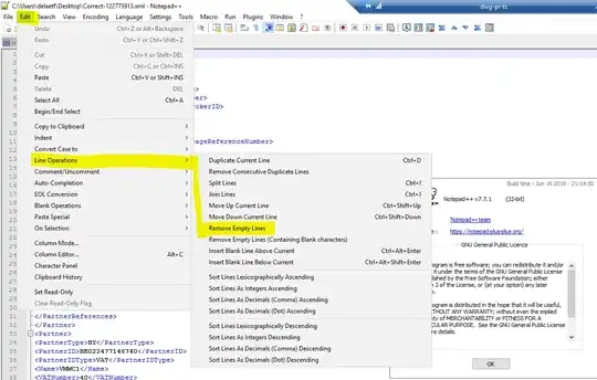

In Notepad++ V7.7.1, in the Edit Tab, in the subgroup "Line Operations" there's the option "Remove Empty Lines".
