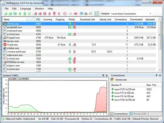

Download the Free version of Net Balancer, run it, it will show you what is using bandwidth and how much, leave it open for a while you will see what is constantly using bandwidth, some of it is an unavoidable consequence of using W7, as it is much more chatty on the network than XP.
If NetBalancer does not help sort it out, Open Task manager, go to the processes tab, tick "show processes for all users", click the "name" header to sort processes by name, then right click on one of the svchost exe entries and select "go to Services", it will open the services tab and automatically highlight all the services running under that one svchost process. Might give you some insight to what can be safely disabled.
