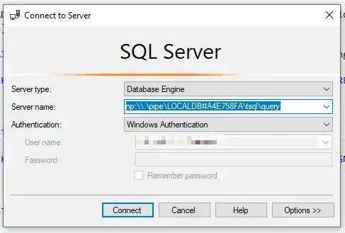

Workaround: Use Named Pipes instead
If it doesn’t – well, there’s a workaround, although it’s a bit laborious. It in fact requires you to know the instance name pipe – a weird, nonsensical URI-looking piece of textual vomit you simply can’t guess. And then, most of the time, you can just use your local user account to log in.
The workaround has quite a few steps, and finally comes down to this beautiful screen below:
using pipeline
But how do you figure out the right Server name? Check out the steps below!

  1. Try using (localdb)\MSSqlLocalDb first That’s definitely the first step – only if it fails, go through the rest of the steps!
  2. Find your friendly local SQL Server Express LocalDB Command Line Tool The location is something like this under your SQL Server’s installation path -> Tools -> Binn.
    So, in order to use the tool, let’s fire up a command line window and write the following command:
    cd “C:\Program Files\Microsoft SQL Server\130\Tools\Binn\” (Replace the version number with whatever’s relevant to your environment!)
Under servername, type either
or
.\sqlexpress
