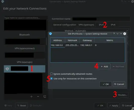

In response to the comments asking for an easy linux / networkmanager friendly solution to customizing what gets routed over OpenVPN, here is a GUI friendly way to set it up. This answer is, as far as I can tell, just the GUI version of Thomas's answer.
Screenshot of network manager showing where to click
Step 1: select your VPN configuration
Step 2: go over to the relevant tab (either IPv4 or IPv6)
Step 3: Click the "Routes..." button in the bottom right
Step 4: Add your desired route (in this case it is redirecting all traffic from 192.168.0.* through the VPN
Step 5: check the "use only for resources on this connection" checkbox so that connecting to the VPN doesn't change your default gateway settings to route all traffic through the VPN.
