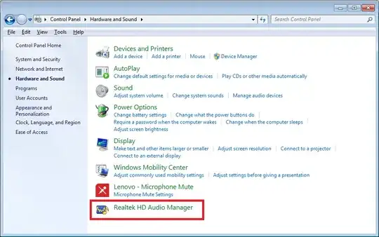

I was able to fix the internal microphone in Realtek HD Audio Manager:
  1. Open Control Panel → Hardware and Sound → Realtek HD Audio Manager.
    Control Panel

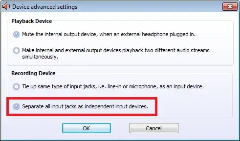

  2. In Realtek Audio Manager, select "Device advanced settings" in the top right.
  3. Select "Separate all input jacks as independent devices" and click OK.
    (If you don't see an option to separate jacks, you may need to update your Realtek Audio drivers.)
