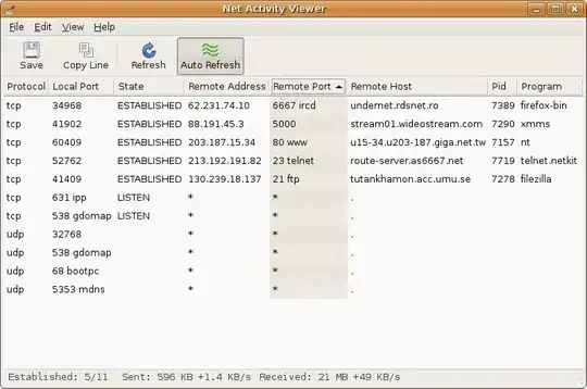

I would recommend you to use Net Activity Viewer to determine what process/service is keeping this port on listening state:
After this, Google the process name to see if there are any viruses related to this process and to this port.

  • I am on a linux machine. Is a sudo netstat -lntp | fgrep 1111 equivalent of this? – nknj Jul 19 '12 at 14:52
  • @Nikunj Edited to Linux TCP View program. Probably netstat can't list prot related to processes. – Diogo Jul 19 '12 at 15:00
  • Thanks a lot @Diogo. Is there a CLI thing that helps me do this? I do not have a ubuntu gui install on my server – nknj Jul 19 '12 at 15:03
  • looks like iftop and iptraf are alternatives on the cmd line. – nknj Jul 19 '12 at 15:09
    Try this guide: http://www.cyberciti.biz/faq/what-process-has-open-linux-port/ – Diogo Jul 19 '12 at 15:13
