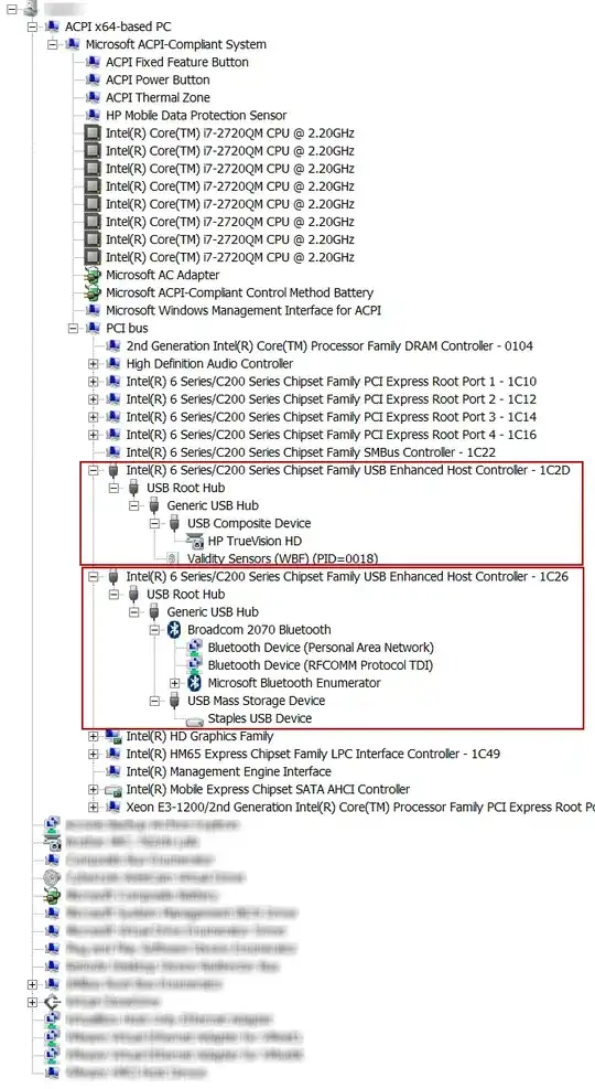

It's possible another device connected to that USB root hub is drawing enough power that the 1 TB drive is insufficiently powered. You can see what other devices are on the same USB Root Hub by doing the following:
  1. Click the Windows (Start) menu, right-click on Computer, and select Manage
  2. Click on Device Manager
  3. Click the View menu and select Devices by connection
  4. Expand ACPI x64-based PC/Microsoft ACPI-Compliant System/PCI bus, then expand each USB Enhanced Host Controller as far as it will go. You'll be able to see all the devices that are connected to the controller and could be drawing power from it.
