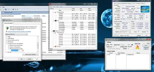

Depends on your processor but limiting the CPU maximum can definitely decrease the amount of heat generated. First keep in mind heat is dictated by Vcore voltage not frequency. So if you can limit your processor to a lower P state it will also limit the vcore voltage. Keep in mind this is only on newer Intel processors (I assume AMD as something similar) so I think this is where the confusion is comming from. I did some tests to prove my theory.
  1. First up I let my I7 3930k @ 4.2Ghz run a pass of linpack and took a screen shot of vcore and temperatures:
As you can see after one pass of linpack my CPU package is at 55C

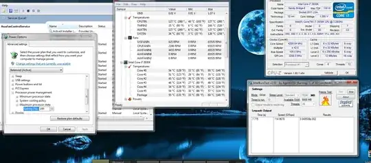

Now I limited to 75% and ran another pass of linpack: enter image description here
Notice the differences in vcore at 4.2 Ghz vs 2.4 Ghz, 1.280 and .984. In terms of Vcore that is a HUGE difference. Notice how the heat generated reflects this: 55C vs 40C.
So there is some truth to limiting the frequency lowering the heat generated. Although a CPU at 3.8 GHZ wiht 1.28 Vcore and a CPU at 4.2 Ghz with 1.28 Vcore will generate the same amount of heat so this is only relevant for CPU's that undervolt as well as downclock.
