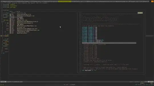

I like to switch windows/tabs with fzf-vim. It is fast and
For instance you can make a bindkey <leader>w which calls Windows or Buffers. Also Jumps and Changes are useful tools for fast switching.
Buffers:
Windows :
Here some maps for fzf I am using frequently:
nnoremap <silent><Leader>f :Files<CR>
nnoremap <silent><leader>j :Jumps<CR>
nnoremap <silent><leader>c :Changes<CR>
nnoremap <silent><Leader>m :Marks<CR>
nnoremap <silent><Leader>w :Windows<CR>
nnoremap <silent><Leader>h :Helptags<CR>
nnoremap <silent><Leader>b :Buffers<CR>
nnoremap <silent><Leader>bl :BLines<CR>
